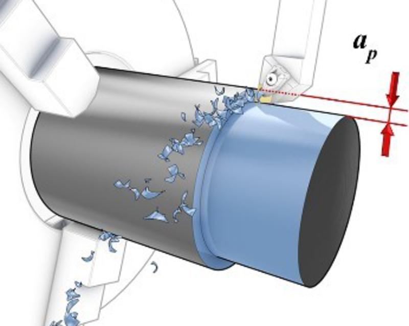

In turning, the machining process is governed by three primary cutting conditions: cutting speed (vc), feed rate (f), and depth of cut (ap). These parameters each play a pivotal role in defining the efficiency and precision of the operation.
In the Secrets of CNC Turning, achieving optimal cutting conditions is vital for producing high-quality parts efficiently. In this article, we delve into the essential cutting conditions of CNC turning and explore their application.

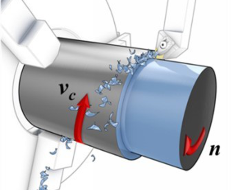

The “Cutting Speed” represents the surface speed along the circumference of the rotating workpiece relative to the cutting edge.
On a CNC Lathe, the machine maintains the workpiece’s surface speed even as its circumference reduces in size.
It is expressed in meters per minute (m/min) or feet per minute (sf/min) with the mathematical symbol “Vc.”
It’s important not to confuse “Cutting Speed” with Revolutions Per Minute (RPM), which refers to the number of turns completed around a fixed axis in one minute.
The “RPM” remains constant throughout the operation and is measured from the spindle’s axis. To convert between “Cutting Speed” and “RPM,” specific formulas can be used.
Another vital parameter is the “Feed,” also known as feed per revolution and feed rate.
The “Feed” represents the distance the cutting tool advances along the length of the workpiece for every spindle revolution.
This dynamic measure is expressed in millimeters per revolution (mm/rev) or inches per revolution (inch/rev), and its mathematical symbol is “f.”

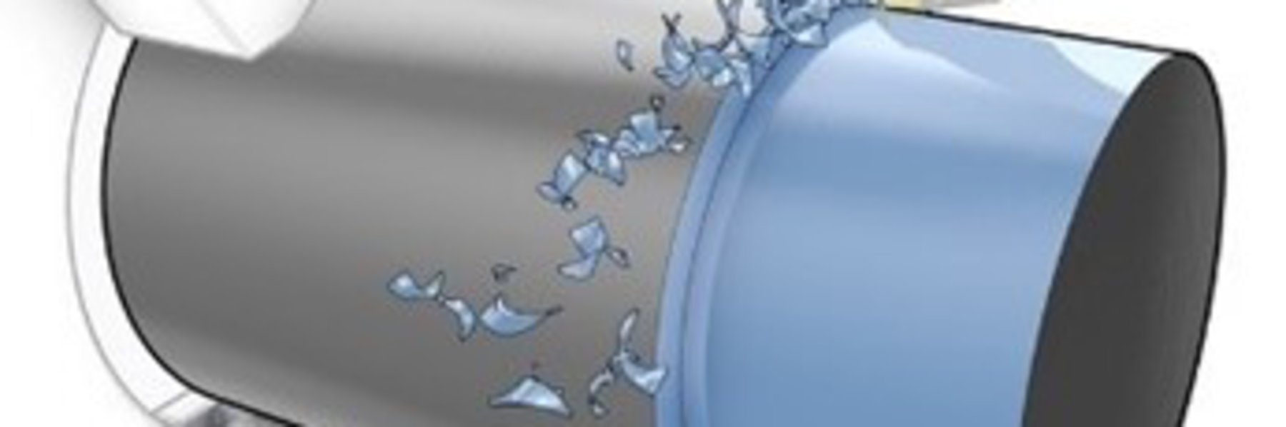

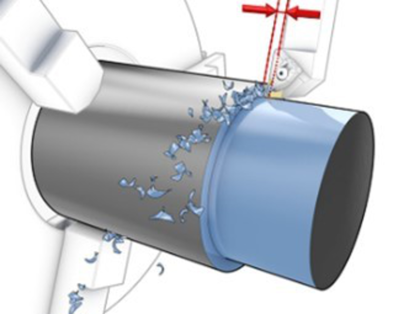

Finally, the “Depth of Cut” unveils the amount of metal removed by the cutting tool during each pass.
This perpendicular distance is measured from the machined surface to the uncut surface of the workpiece.
For instance, when turning a workpiece with a diameter of 100mm down to 90mm in a single pass, the resulting “Depth of Cut” would be 5mm.
Its mathematical symbol is “ap”.

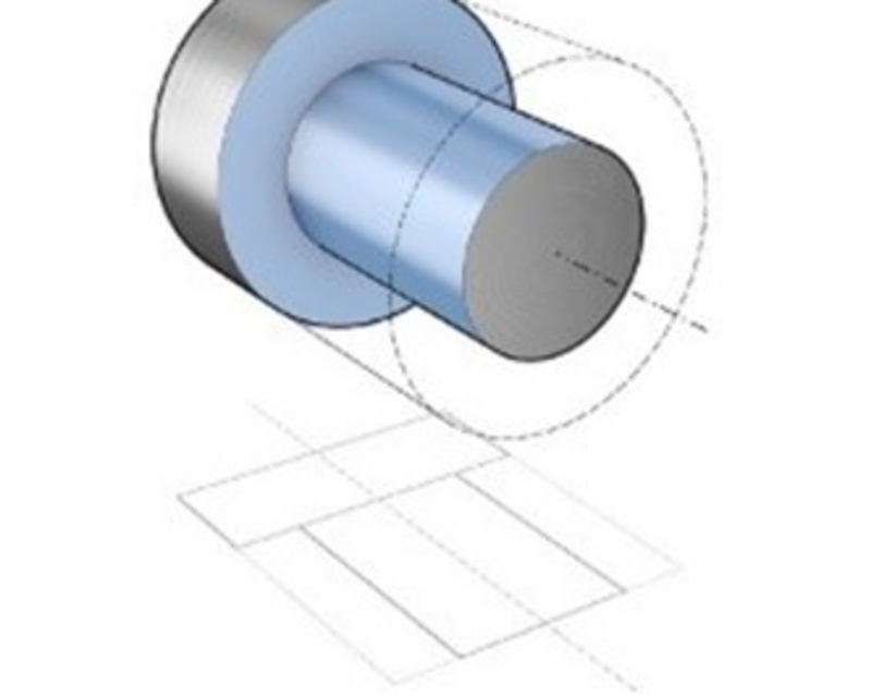

OD Turning is without doubt the most common turning operation.
It involves removing excess material from a workpiece’s outer diameter or cylindrical surface until the desired diameter is achieved.
Shoulder turning, is a technique that creates a workpiece with abrupt changes in diameter.
This results in a distinctive “stepped” appearance, making it a valuable operation for parts with unique geometric requirements.

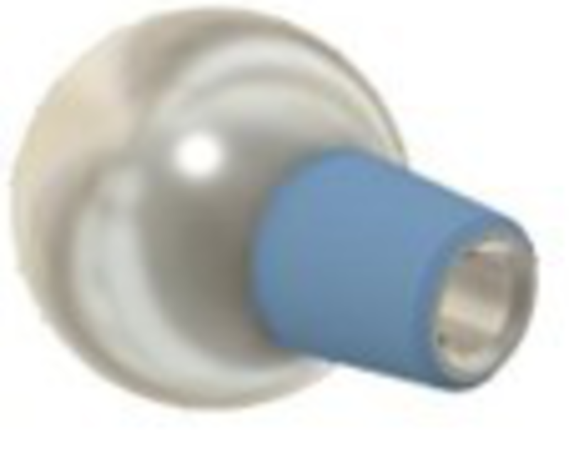

Taper turning on the other hand, is a process that produces a gradual transition between surfaces with varying diameters.
This is achieved through angled movements between the workpiece and cutting tool, allowing for the creation of tapered components.

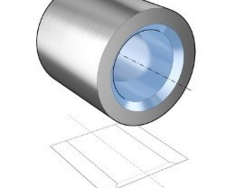

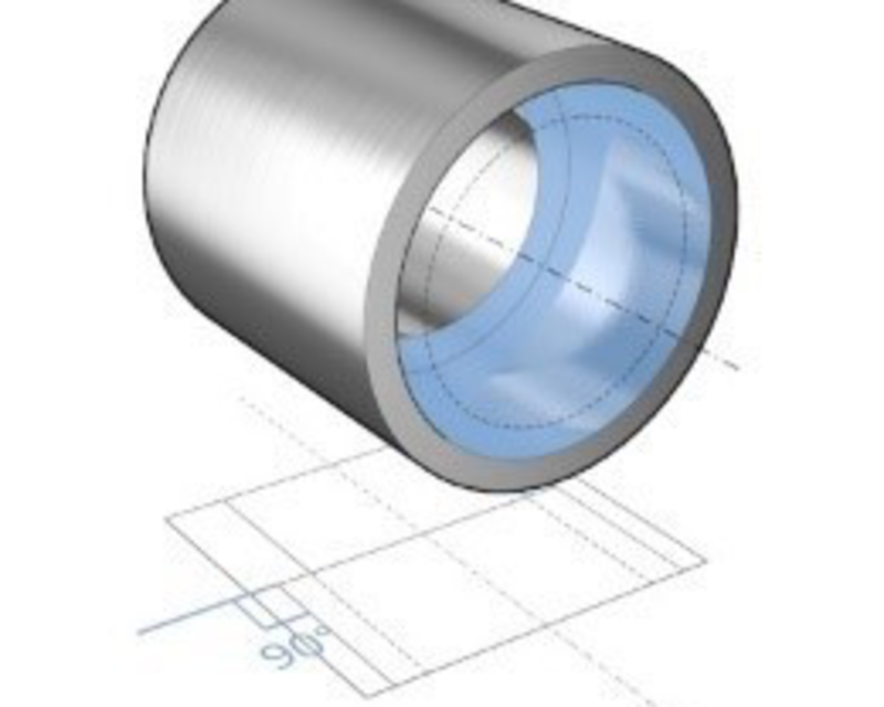

Like step turning, Chamfer turning introduces an angled transition between surfaces with differing turned diameters.
This operation is used for adding chamfers or beveled edges to workpieces.

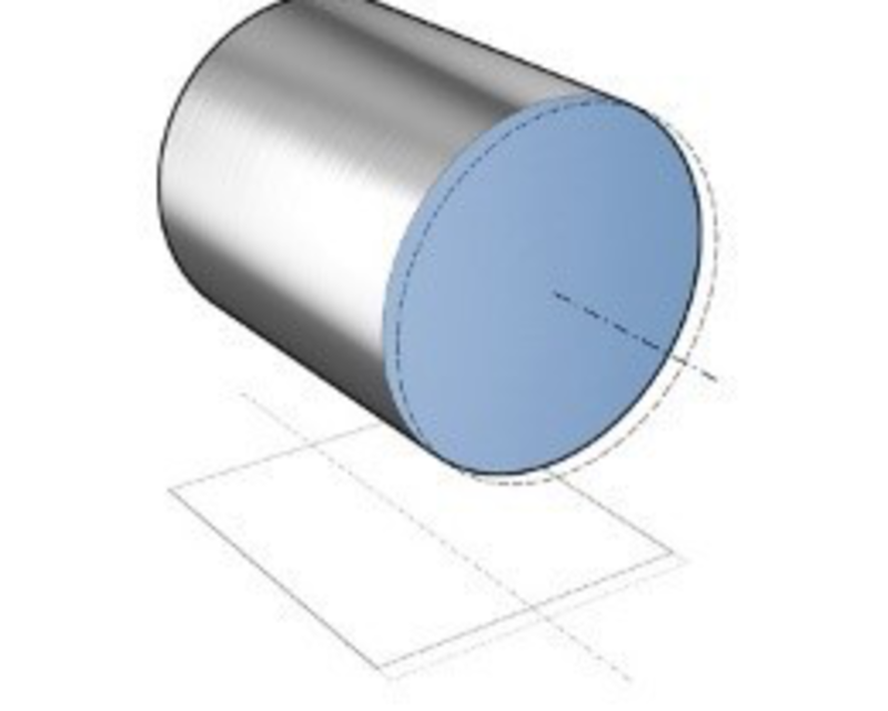

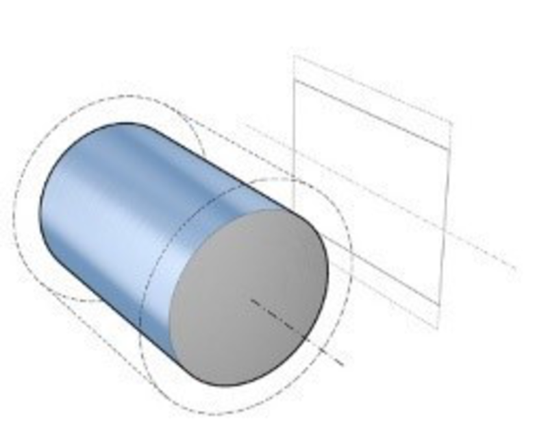

Facing is a machining operation that shortens the length of a workpiece, addressing discrepancies that may arise when the workpiece’s length slightly exceeds the intended dimensions.
The cutting tool moves along the workpiece’s radius to attain the desired part length, ensuring the workpiece’s end is perpendicular to its axis of rotation.

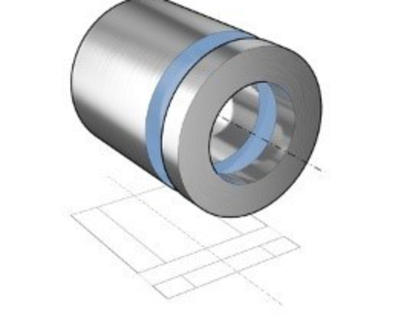

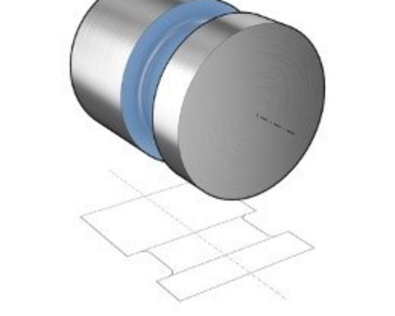

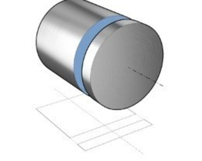

Grooving entails creating a narrow cut in a workpiece.
The width of the cut depends on the cutting tool used, and for wider grooves, the tool may follow the same path on the workpiece multiple times.
Two distinct types of grooving operations exist.
Axial grooving (face) creates a narrow cut on the workpiece's face, and radial grooving (external and internal) removes material by moving radially into the workpiece's side.

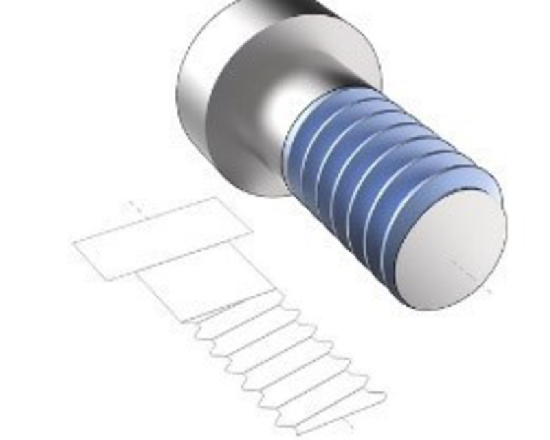

Threading is a pivotal turning operation conducted on a lathe machine, where a mechanical tool meticulously carves threads onto the outer surface of a workpiece.
This process involves the tool moving alongside the workpiece, sculpting helical grooves with specified pitches and lengths.
The tool may traverse the workpiece multiple times to achieve deeper threads.
Employed for this task is a thread-shaped carbide indexable insert.
The success of this operation hinges on precise machine setup. In cases requiring multiple passes to attain deeper threads, the machine must initiate the helix from the same starting point.

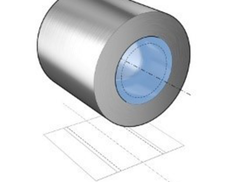

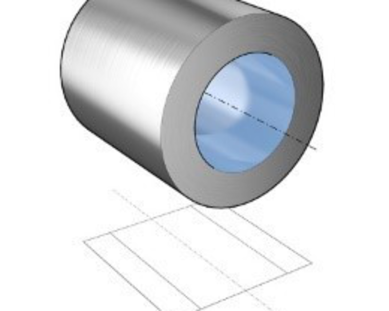

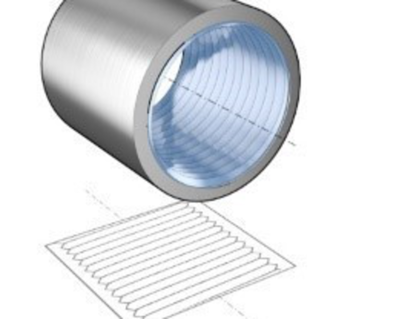

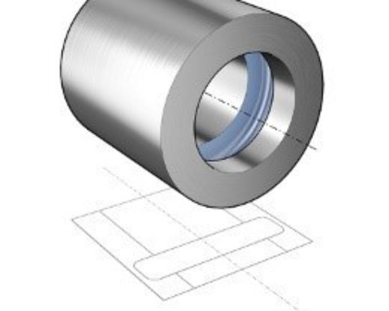

ID Turning (otherwise known as boring) is the process of removing excess material from a hole within a workpiece.
A 'single point' cutting tool is used to enter the workpiece axially, shaping it to specified dimensions or making existing holes deeper or wider.
It’s essential to note that boring cannot create a hole from scratch; it is employed when a hole has already been drilled.

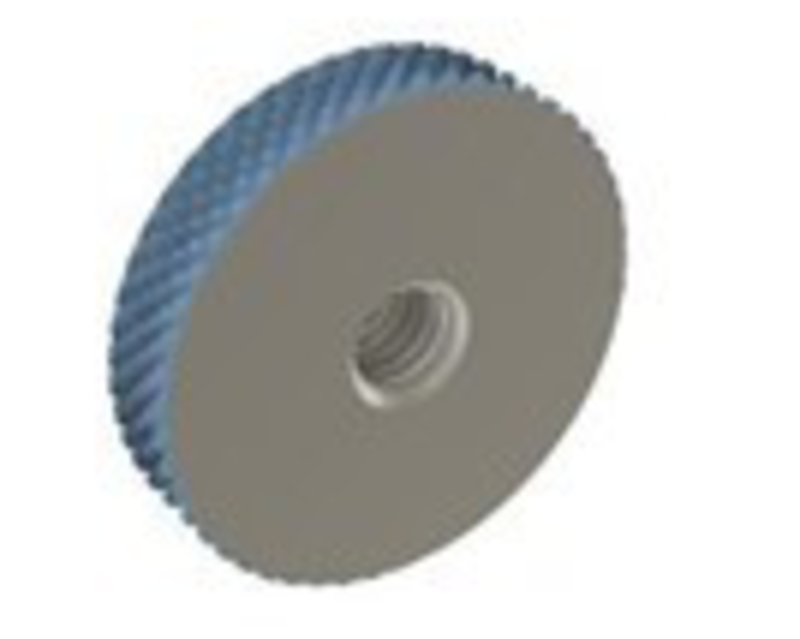

Knurling aims to create serrated or diamond-shaped patterns on a workpiece's surface.
These patterns enhance grip and add an aesthetic touch.
The tool responsible for this operation is called a knurl, which is brought into contact with the workpiece's surface while its teeth roll against it.
