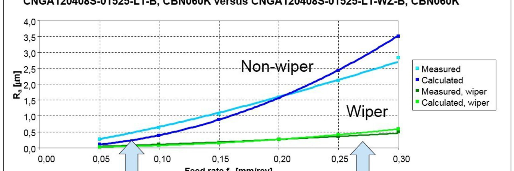

In turning with a single-point tool, the surface finish is determined by the feed rate and nose radius, as these are in a direct relationship to the profile height of the surface (Rmax). This means that the higher the feed, the rougher the surface generated by the edge of a given nose radius.
Standard insert geometry
The difference is in the nose radius. The nose on a wiper insert is actually a combination of radii instead of a single radius.
The large wiper radii enable the cutting edge to generate improved surface finish.
The Seco way, Solid TNGX11… inserts - 6 cutting edges with wiper.
