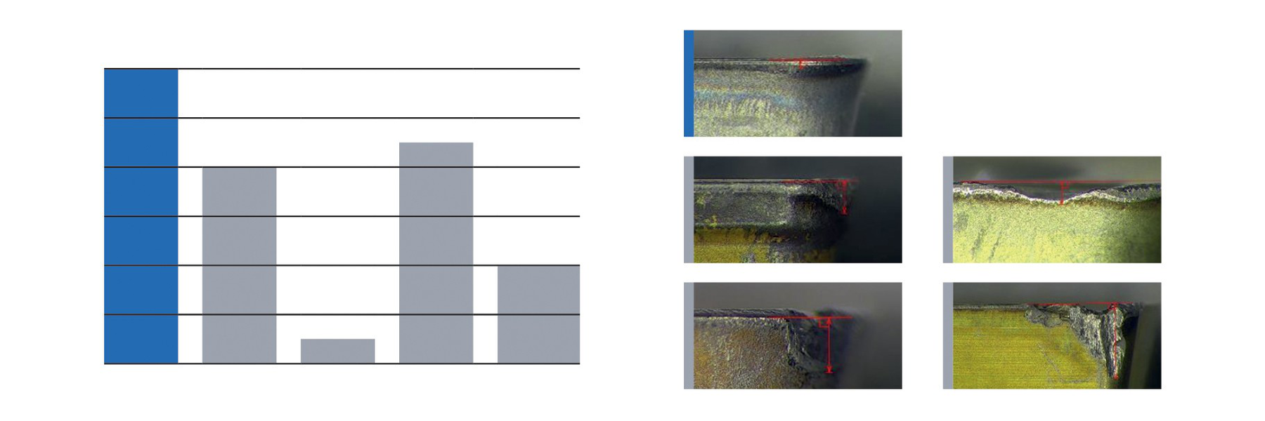

Tool life vs competition
A test was conducted against 4 competitors in titanium 6-4.
The image marked with blue shows the results and tool wear after using the High Feed SP07 compared to the other brands while the graph shows the wear rate.
