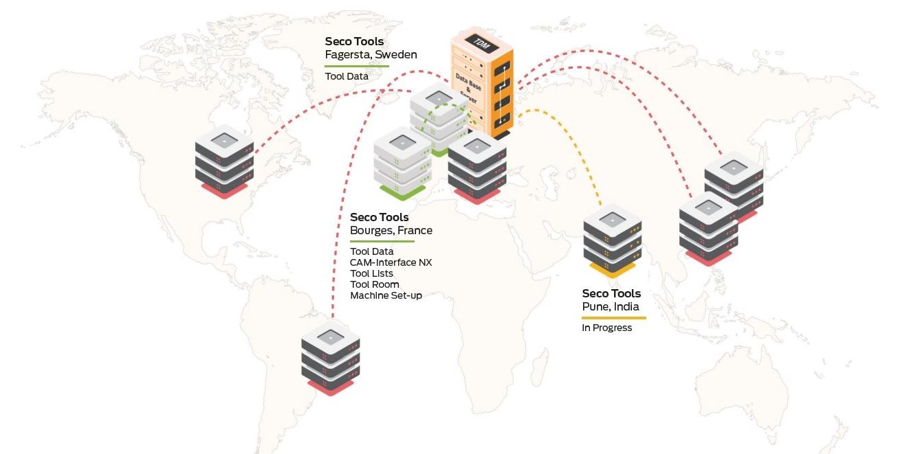

As a first step, a database of more than 1,200 references was created, integrating all the information and characteristics related to the cutting tools and completed by a digital catalog composed of 2D and 3D graphics. Information such as videos or photos could also be added to the tool, if needed, to better guide the operators. Once the database was created, for each NC machine programming, it is then sufficient to transfer this complete tool data via an interface from the TDM tool to the CAM system NX at the touch of a button. After finalizing the NC program, all machining information such as tool lists, necessary equipment and the machining program goes back to the TDM system.

Once the process was mature in Bourges, the project began to be deployed in Pune (India) and Arboga (Sweden ), from servers hosted at Seco‘ s parent company in Fagersta (Sweden). Since the database was already created and centralized on these same servers, both sites were able to use it immediately. In addition to optimizing IT costs, this centralization was very useful during the lock down period because the project could continue to be deployed and controlled remotely. Roch Rivière, TDM Administrator at Seco Tools, comments on the project: „We are very satisfied with the collaboration with TDM Systems. Seco Tools, a global group, now has a solution that forms a common backbone for harmonizing the management of its production units. With unified working methods and data, it is possible to increase our flexibility by transferring the production of certain parts to different
